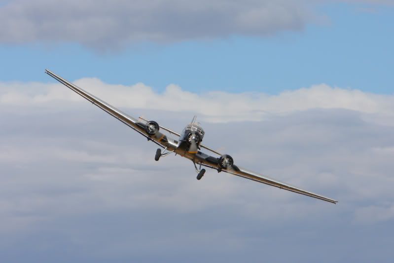

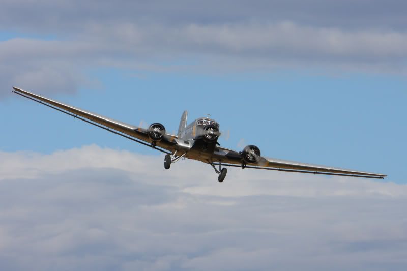

Unread post by photon » Sat Apr 25, 2009 7:14 pm
some pics of the "test flight" at Parys this afternoon
