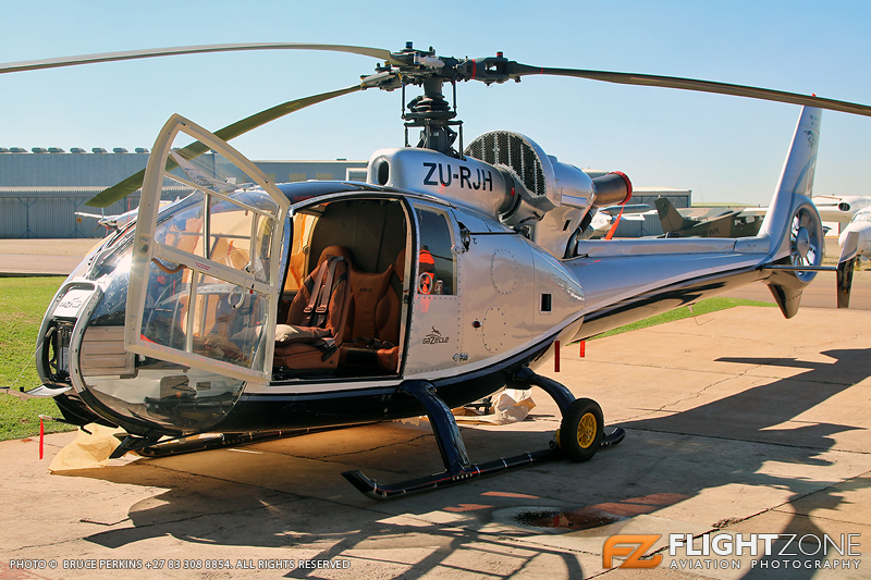

Unread post by Bearcat » Fri May 26, 2017 9:05 pm
Aerospatiale SA-341 Gazelle ZU-RJH at Wonderboom Airport FAWB
18 May 2017
