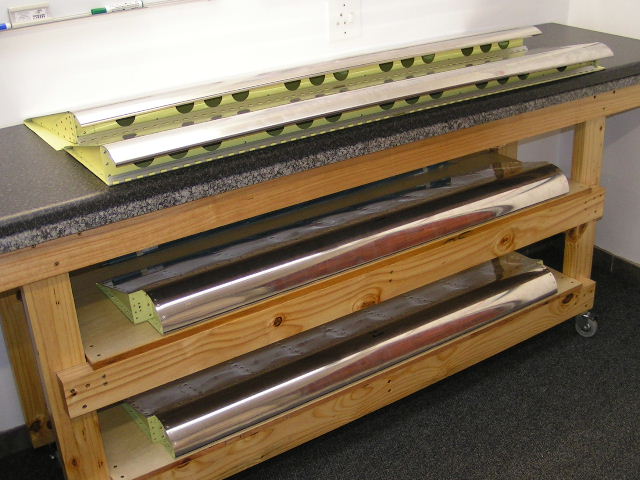

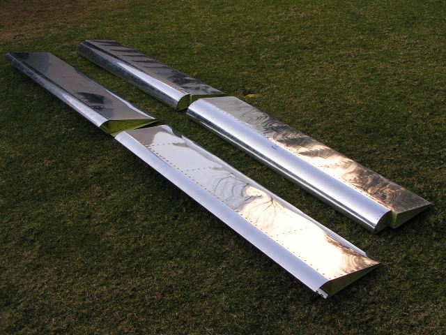

I know there are a couple of fellow RV builders lurking around on Avcom...so I just wanted to say to all of them:
It seems like Xmas...I-ho...I-ho...the flaps and ailerons on done, it's onto the wings I GO..I-ho..I-ho... :lol:
