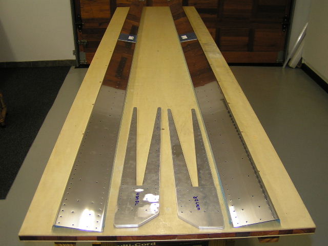

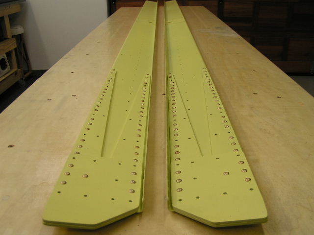

This week I finished drilling, deburring priming and riveting the rear wing spars and the tie down assembly.
More photos are on my web site under the ‘wings’ link.
Next on the task list is to prepare the main wing ribs...I took them out the box so long and inspected them...Pretty rough and very bent. There are a lot of ribs so it is going to take some time to get them into the right shape and to prepare them to ‘aircraft quality’. Some borring work waiting for a while...Luckily I do not have to scratch build them!

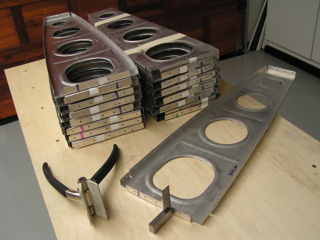

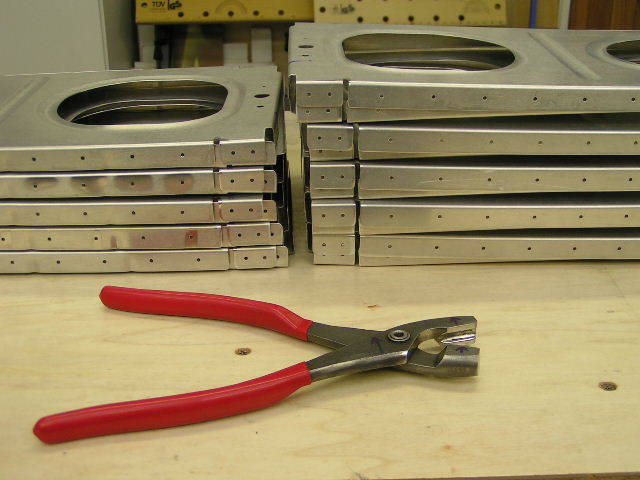

OK this is what I had to do:
1) First you need to debur the lightening holes in the rib web. They are very rough.
2) Next you have to take off those ugly white stickers depicting the part #. What a pain, since it interferes with bending, deburring and priming.
3) Next you need to bend the rib flanges 90 degrees to the webs all around, you need to do this because they are punched out of sheets and the bend is not 90 degree. If you don't do this your wing skin will not set flat. In the picture below is my bending pliers and set square.
4) You need to debur the flanges.
5) You need to flute the ribs to get them to lie down flat and straight.

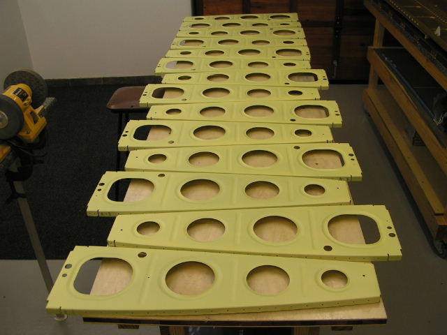

In total there are +/- 60 ribs, below you can see the main ribs that goes between the main spar and the rear spar just before the Flaps & Ailerons. I am about 30% done with the rib preparation, so don’t expect ground breaking photos soon.

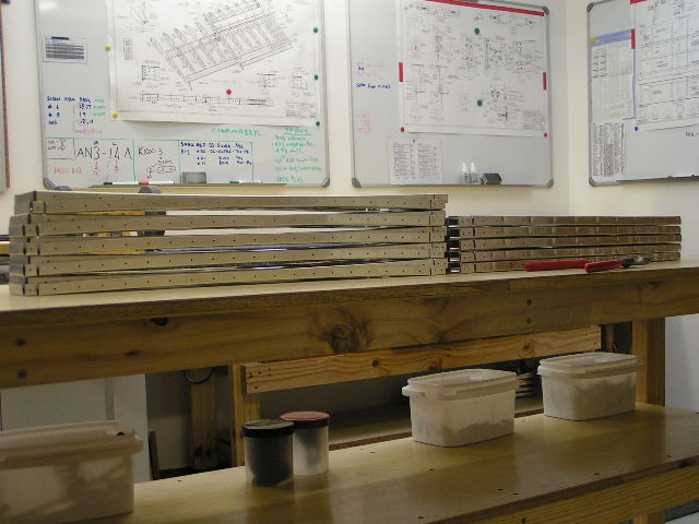

Here you can see the same amount of stacked ribs, before and after fluting...nice and striaght.
A Close up of the fluting tool and stacked ribs.

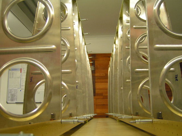

To my fellow RV Friends,

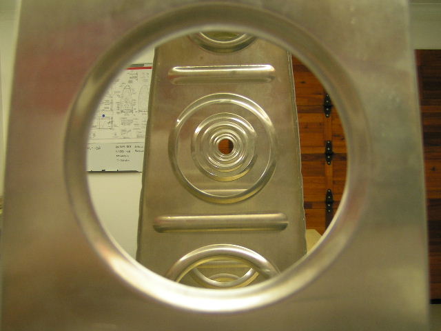

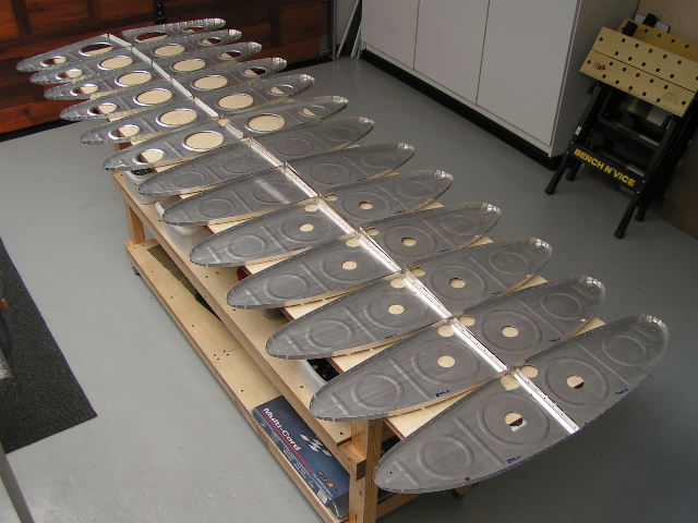

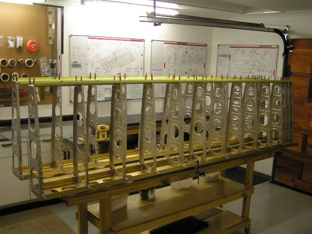

After 2 weeks of borring work getting the main wing ribs into airworthy shape, I was rewarded with the main wing skeleton. It feels good. :P
The nose ribs, the tank ribs are closest.
The left wing skeleton clecko'ed together.
And the right wing one.
I like this abstract picture
And this one.
Next I need to match drill the wing skeleton, debur, take everything appart, prime it, then put it all back together and then Brrrrrrrrttt, rivet them.

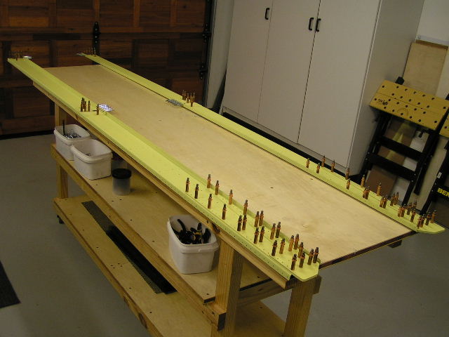

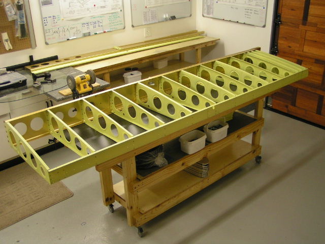

I managed to prime all the main ribs and rivet the wing skeletons together. Those main spar rivets are pretty tough to do, but my wife helped and she does a pretty good job. Her new nickname is 'Rosie Riveter' :P
Next I have to build 2 wings stands in order to make working with the wings easier.

Moved to the other garage for bigger space, added some additional fluorescent lights on the ceiling for better lighting, finished fabricating the wing stands and put the wings into place.
Yeah baby!!! Now we are ready to do some real airplane work again!

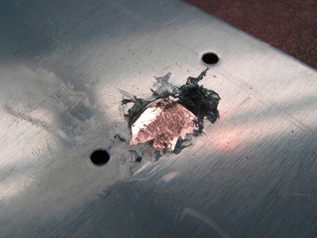

Bummer, started to clecko the skins to wing and what do I notice... :evil:
I did not see this during my inventory check, and I did not cause it either.
The problem is this is going to be on the outside skin in the middle of the wing! A nice eye sore!
I send a quick email to Vans aircraft with pictures, to check what the say...expecting the usual 'Don't worry build on' reply. This time they changed their tune, saying immediately they will replace the skin. WOW fantastic!
Now all I have to do is keep myself busy with other odds and ends until the logistics is sorted out and the new skin arrive.
