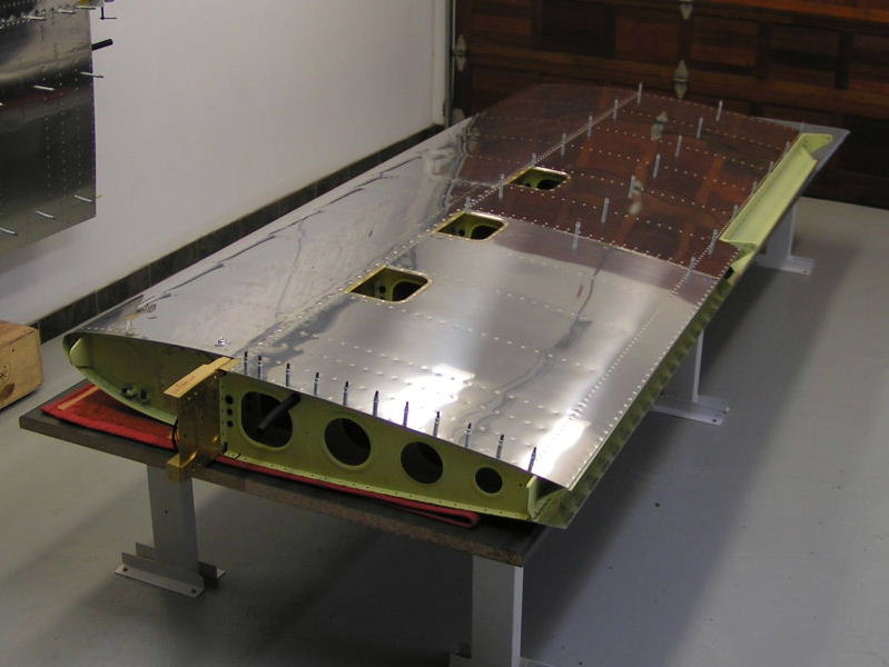

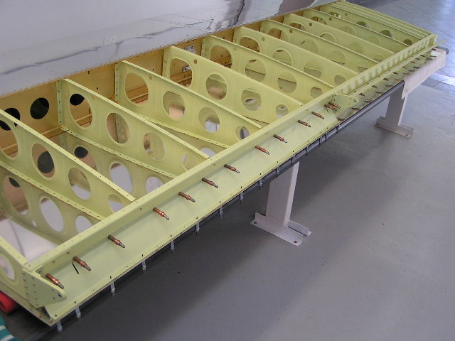

I fitted the tanks to the wings, this setup looks so sweet!

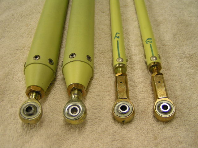

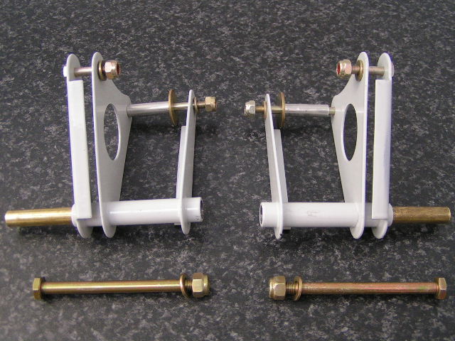

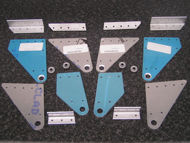

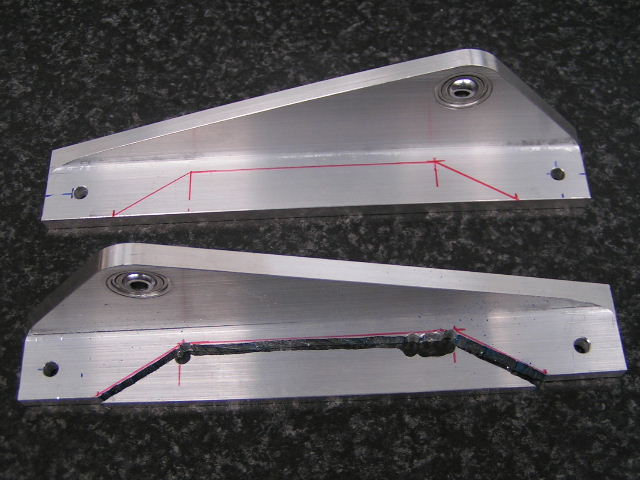

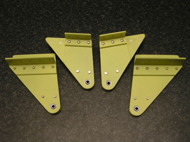

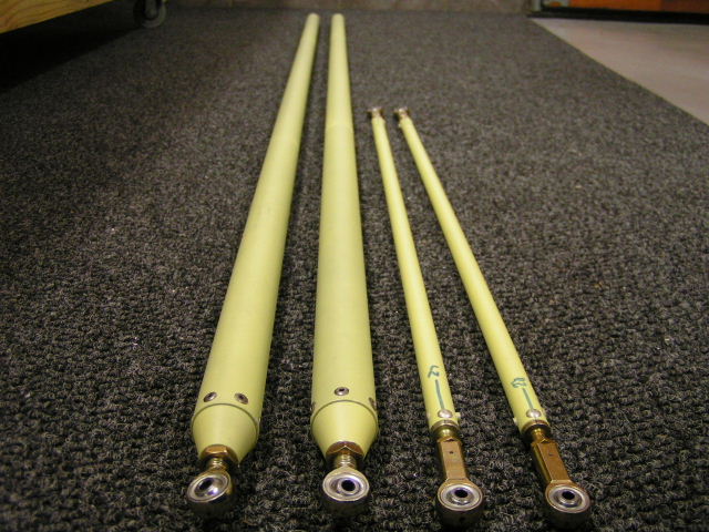

Then I finished the aileron brackets, and aileron push rods:
The bracket components
The brackets assembled
The aileron push rods close up
The long picture (Long push rods left, short push rods right)

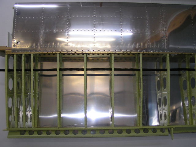

The wings will come of the stands the weekend, to finish connecting the ailerons and flaps. I've decided to leave the bottom skins off until very late in the project. The reason is that I might fit an autopilot servo and nice pitot tube, and the experimental aircraft technology changes so quickly that every 6 months there's new cheaper stuff.

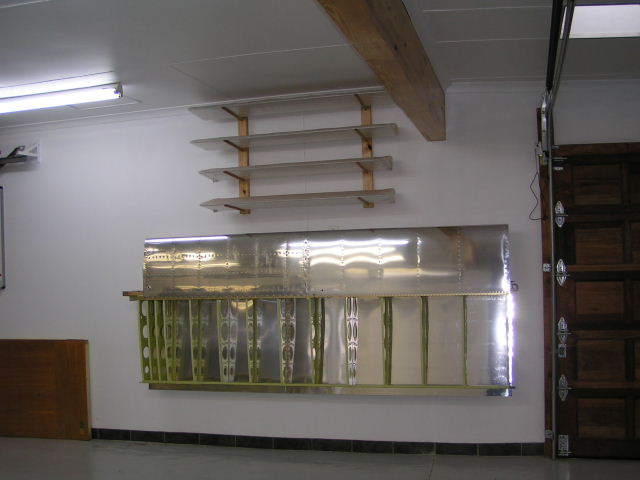

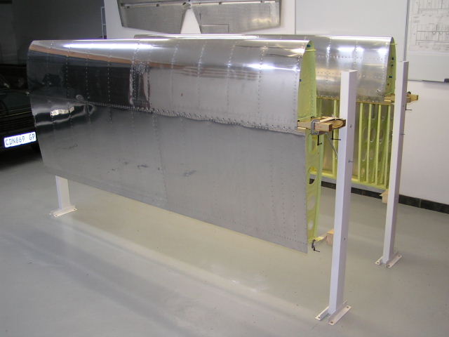

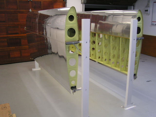

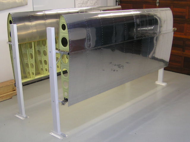

Back home the wings came of the stands and I build some brackets to put them onto the wall.
The plan is to hang the ailerons and flaps soon.

Back to the RV…I managed to fit the Aileron Brackets and Flap Gap Fairings and manufactured the aileron bell-crank bushings to fit the bolts. I also pulled the ribbed conduit for the electric wires, what a pain to get it through the holes.

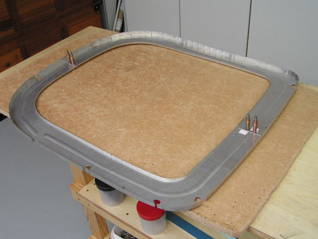

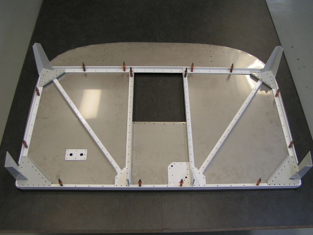

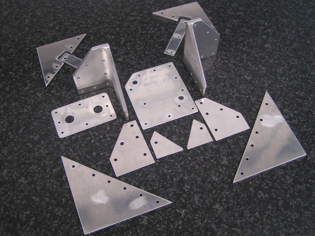

Any case I started on the fuselage last week. The quality of the RV7 kit shows. I was impressed how perfect the firewall came together. The firewall has a lot of stiffeners, spacers, gussets and brackets mounted to a stainless steel backing. It goes together like a puzzle, and like a ‘Mechano’ set everything fitted perfect, first time.
Here are some of the firewall components
Here is the firewall clecko’ed together

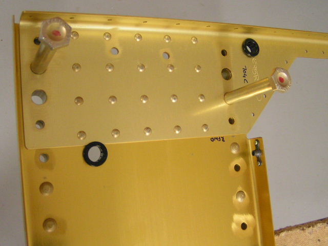

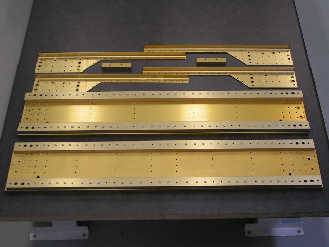

I also started working on the centre section where the wings attach. The centre section is the hart of the fuselage since it carries most of the wing load to the fuse and fuse loads. Here once again the RV7 kit shines. Below is a picture of the golden anodised centre section, looks like it belongs in a jewellery box.

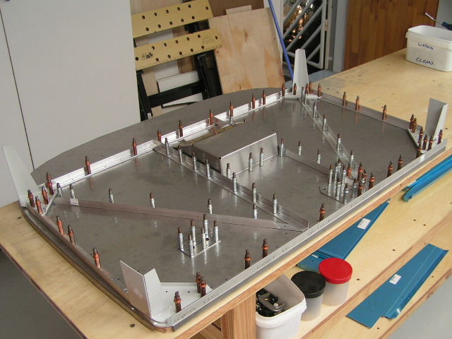

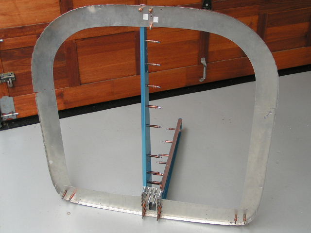

been very busy with my day job and worked lot of overtime, taking time away from the RV. I managed to do a lot of prepwork on the firewall and bulkheads, match drilled them and primered the lot. A lot of small things need to be manufactured and was done. I'm now ready to start assembling the bulkheads.
We should see some real progress in the next week or so...
Here are some pictures of the past weeks:
The firewall:
Some of the bulkheads:
Some parts for the center section, the control column mounts:
The wing bolts for the center section, and center section uprights riveted on.
